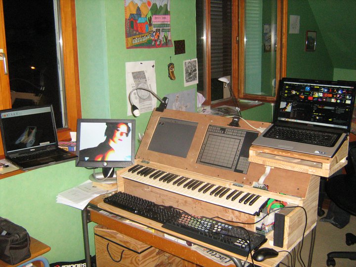

I'm a new (french) freestyler user, I'm 17, and i've done a little diy light controller:
But I've got a "bug". I use the keyboard to start cue and overide buttons, but the velocity must be 127 to work as a switch, so I must hit the keyboard. I tried to Deactivate the velocity in the keyboard seting, but it set velocity to 85, so it doesn't work anymore. I have searched a programme who set the maximal velocity As soon as the velocity is differente of zero, but i found anything.
Does anyone know something about that ?
(sorry for the bad englisj :oops: )
