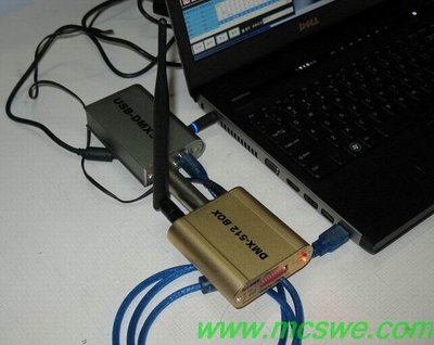

I have tried a similar configuration using wireless dmx tx/rx devices with the dmx source being an art-net dongle (DMX King - eDMX1). Somehow there is interference that causes all the light fixtures to reset momentarily about every 60 seconds. This doesn't happen when I use the wireless dmx with a hard dmx controller as the source. I believe this is because the 2.4ghz dmx transmitter is using the same frequency as the wireless router that the art-net dongle is attached to. It may just be the particular brands of wireless dmx and art-net dongle, I am using. It could even be the dmx fixtures. I have noticed that a couple fixtures tend to reset themselves even when no wireless DMX is in use and may be sending a signal down the line that either the art-net device or the wireless dmx reacts to. Perhaps it is a reaction to static electricity that the hard controller can handle, but the art-net cannot. There is not much documentation on the wireless dmx devices, but it says they automatically search through 26 channels, so I also wonder if they happen to be cycling through and hitting the frequency that interferes with the wireless router on a regular interval.
What I have figured out is that I can use art-net via a wireless router or the wireless dmx devices, but not both.
If anyone has an idea about how to stop the problem (interference issue) I am having, please let me know.

If you can't preselect the channel on the dmx wireless hardware then have you tried a different channel assignment on your router? You can usually log in to it and select one specific channel, or sometimes even reduce the width of the band that channel is occupying.
Another option if your laptop wifi/drivers allow is to conduct a 'site survey' to see which channels are more or less congested than others.
