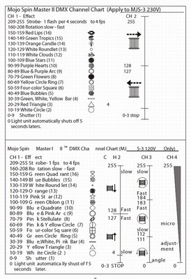

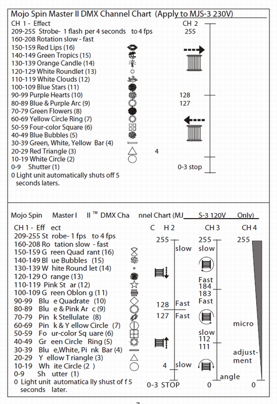

Hi there community i am wanting you guys to create a geni mojo spin master 3 and 2 i will attach a link of the picture.

Hi you may have to wait long time.
Why don't you try to do it your self.
It is not that difficult to do.
The only thing you need is the dmx table and then give it a try with fixture creator.
Additional you have the possibility to test it while you are building it.
I am not sure if you have a 2 channel or a 4 channel version but!
Think if I was to build it I would place CH3 on PAN, CH2 on Tilt, CH4 on "intensity channal".
Shutter ch = 1, open = 15, Closed = 0
Strobe ch = 1, low = 209, med = 232, high = 255.
goboch.1 = 1, n gobos = 8, And then you have play a bit with the gobo's
And when you have a working fixture then upload it here.
