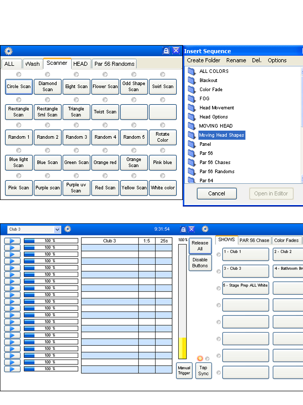

I would like to create an effect where my scanners move in a shape like triangle or circle, and each scanners lamp intensity changes during the shape at different intervals.
so scanner 1 maybe at 20 % brightening to 100 % and
scanner 2 is at 100 % dimming down to 15 %
What is the best way to achieve this technique ?
Currently I normally run my show with the over ride buttons. and pre programmed shows with the cue list buttons

did you allready take a look at the FX generator?
Koshy
Re: Scanner Intensity
Post by Koshy »
yes, I see why its not working ... my scanners are low budget and do not have a intensity just Shutter open / strobe :cry:
Post by Spirit »
ahhh, yes that explains a lot
