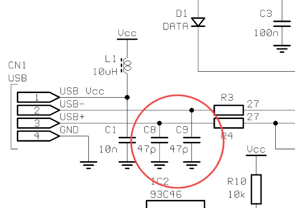

Johnny Wester of CPOINT Lighting (06/05/05)
has come up with this fix for the widget which might cause it
to lock up locking up after a while of use, typically
it takes some time before this happens...
'Some hubs and host controllers appear to be extremely sensitive to noise. A
glitch on the USB lines can causes the device to hang. This problem can be
fixed by adding two 47pF capacitors to ground on the USB DP and DM lines.
These should be located between the 27ohm series resistors and the hub.'

mcmcomput
Re: Enttec Open locking up fix.
Would someone who has completed this mod post some pictures of how it turned out? Its all so small.

infinity6
I had this problem on my first public show, Valentine's Day. The DMX <-> USB communication would stop about every 5 minutes. Fortunately, half of my fixtures have a "feature" that if they don't hear DMX, they go into sound active mode. So at least those scanners did their "spaz and flail" while I reseated the USB and restarted Freestyler. Between that and the other fixtures merely freezing their movement but staying lit, the audience really didn't realize the computer failures.
I was so busy before my BIG show this last weekend (and also my birthday party) that I did not have time to go buy the 47pF capacitors to make this mod. I did find in my collection some 100pF caps. Having a bachelor's degree in Electrical Engineering, I knew that doubling the value of the capacitors would probably be close enough in this filtering application, and if it didn't work, then two 100pF capacitors in series would.
So I soldered in the 100pF caps and voila, no hangs the entire night!
For the record, this mod works per my experience using 100pF capacitors. I will take a picture to post, since it was a bit difficult identifying where to solder them on, and also because somebody else requested it.

vinnygogo
could anyone post some pictures from where to solder the 2 capacitors? i need it working this weekend, but i cant realy find the components metiont on the modifications schematic.
please help me a.s.a.p.! thanks in advance
vinnygogo
nobody?? please help me, if you need a picture of mij dongle's pcb i'll post it!
- djSupport
- Posts: 1916
- Joined: 09 Jul 2007, 18:57
The picture on the front page shows where to solder, if you need help with working out the drawings do a Google for electrical drawing symbols to navigate your way around, me personally ran a big rig with no issues if you've got the money though go and buy the pro version it's not much in terms of cost and use your open as a backup...
vinnygogo
hello,
i understand the scematic, but i cant find the components on the pcb shown on the scematics. i cant find r3 and r4 and the ground. so please help! i dont have enough money to buy the pro, so that is why i choose to do this!
- djSupport
- Posts: 1916
Are you actually getting the problem? If not don't worry because enttec may have fixed the issue and you have a different PCB because of this!!
vinnygogo
hello,
yes i do have the problem, it locks up about 10 times during a 4 hour show. and that is realy disapointing. maybe its because of my small pcb skills, but i cant find the components. so if anyone is able to post a picture of its modifications, that would be great! i could also upload a picture of my pcb if neccesairy
- djSupport
- Posts: 1916
I would do that show us your pcb then someone might be able to help you or indeed contact enttec they are a real friendly bunch of guys and they may even give you the solution!!
