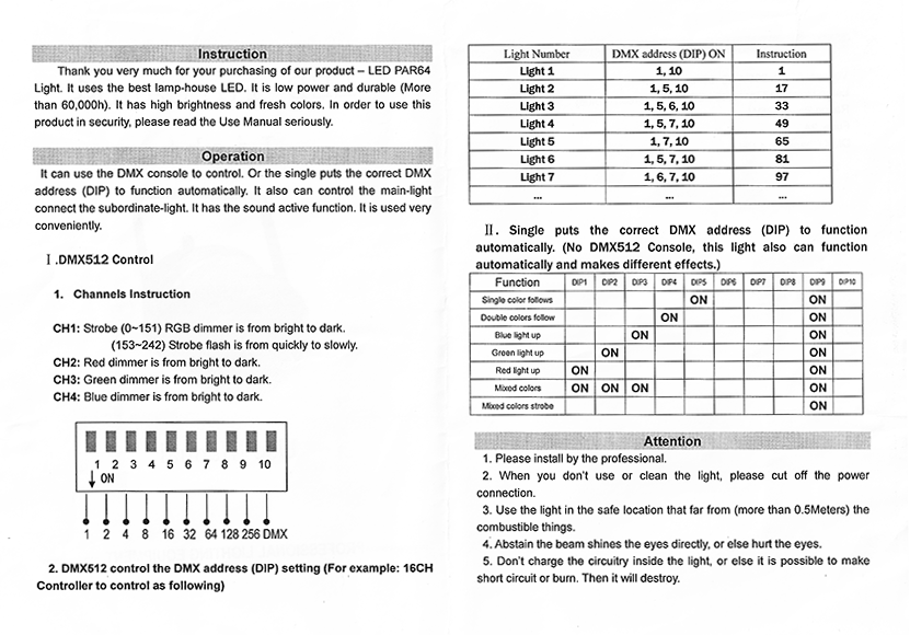

When I bought the two LED PAR cans they did come with a manual, but unfortunately
I misplaced it, so I don't know where it is. :S
About the dip switches, these are some of the configurations:
ALL OFF -> Responds to Sound
ALL OFF but 1, 2, or 3 -> Outputs RED with variable intensity
ALL OFF but 4, 5, or 6 -> Outputs GREEN with variable intensity
ALL OFF but 7, 8, or 9 -> Outputs BLUE with variable intensity
I don't know what the dip #10 does, but it doesn't seem to produce any effect.
Does this sound familiar to you? Is this the way your PAR Cans operate??

dipswitch#10 could be the one to set the par can in DMX mode.

I would suggest this too. Try to play arround with this settings.LJ_krede.dk wrote:dipswitch#10 could be the one to set the par can in DMX mode.
Also try to plug in the DMX cables before you plug in the power connector of the fixture. I remember, I had to play a round a little liste time I setup the lights... But after some unpluging and reconnecting everything works fine
If you do not have the manual perhaps you know the manufacture and product name (or have themprinted on the fixture)? Often you can finde the manual somewhere in the internet

Could you tell me what kind of combination you use when on DMX mode??
Also, am I doing something wrong while using FreeStyler??
This is what I do:
1. Go to Setup -> Add/Remove Fixtures
2. Choose one from the list and add it
3. Configure the Dip Switches as indicated on the figure
4. Should the PAR Can be reactive right now? Because I change the color, on the color
button, but nothing happens :S

you have to unknown parameters which could cause your issue:
1) you are not completely sure your interface sends out DMX
2) You don't know if the par can receive/reacts on DMX
1) you have to rule out the first one to solve issue number 2. I dont know how to use the enttec open interface but describe how you set it up, then other users may see if there is a problem
2) as you described the par can should reacts on dmx IF the interface sends out DMX.. you should not use a LED par can fixure but do as i wrote in an earlier post. then you are more sure that the par can would light if it gets DMX.
on my led par cans i have 12 dipswitched where #10-12 have to be turned off to get the PAR can in DMX mode, and its differ depending on the manufacture.
two things you could do if possible:
1) borrow another fixture to test out your dmx interface
2) get the par can to one with a known functional system to try out the fixture

Hello guys, thanks a lot for all the help you've been providing me
I can't believe it, but I finally found the manual!! As you said, Dip switch #10 activates DMX Mode.
But now I can't really get it to function correctly :/ I think my Enttec DMX Interface is sending signals
because when I play with the Color chooser, the can starts blinking white light. Maybe now this is a
fixture problem...
Maybe I'll have to create a new fixture profile?? Is this possible? Anyway, I attached two images from
the can's manual. If you could help me with those, it would be great
(I'm sorry, it's a RAR)

What fixture file are you using at the moment for this fixture?
You can ealisy create a fixture file for it using the fixture file creator.
As an example, use the "Kool Light, Par Led 88" fixture. Thats in the list of FS and uses the same DMX channel functionality.
Without editing, it should work with your fixture.
Before using that, check and double check if you configured the DMX start address on the fixture properly.
Example 1: For start address 1, dips 1 and 10 should be on, the rest off. (the fixture now uses DMX channel 1,2,3 and 4)
Example 2: For start address 10, dips 2,4 and 10 should be on, the rest off. (the fixture now uses DMX channel 10,11,12 and 13)
If you have multiple fixtures connected, make sure they don't overlap eachother. So if a fixture is addressed on channel 10, the next may only start at 14 or higher.

Hello remco,
I have only only led par can connected and I configured the dip switches as you said.
All OFF, except number 1 and 10. I also added the fixture that you said, but I still
can't get it to work.
I don't know but there must be something really wrong with me or I can't function with
Freestyler
From the moment I add the fixture to the list, shouldn't it become responsive
right away? I mean, I use the color changer for changing the color, but the LED can doesn't
do anything... Should I click any other button in order for the software to send the commands?

You should use the shutter channel to set the intensity to full first.TiagoCT90 wrote:Should I click any other button in order for the software to send the commands?
Maybe the master intensity in FS is closed. Open it.
Check if you added the fixture correctly on starting channel 1 in FS.
Important one:
Monitor what FreeStyler sends out by opening the output monitor screen. (Menu Edit->show output).
Setting the shutter, R, G and B channel to max (255), should show on the output window value 255 on channels 1,2,3 and 4.
The fixture should be bright white steady, or flashing. (That depends on internal electronics - see the manual what shutter values mean what)
Edit: This is really strange: "CH1: Strobe (0~151) RGB dimmer is from bright to dark."
So, normally when a channel is shared for shutter and strobe at the same time, it always works from 0 (dark) to 151 (bright). (Where the '151' may vary)
But this text is either faulty or the values work the other way around. 0 (bright), 151 (dark).
So try setting the shutter channel to 0. Maybe then a light goes on... Feels strange. But the manual states it.
The same goes for the RGB channels. As if one should set them all to 0 to get a white light. I don't believe it, but it is there in the manual. Guess thats faulty.

Hello remco,
You're a boss
Indeed setting all values to 255 worked like a charm. The LED par can is flashing
pure white rapidly. Although, for some reason this is the only color that works.
If I change the color, but still keep the Shutter at 255, the LED Can does not show
any color steady of flashing, nothing. Same if shutter is 0.
Also, changing the speed on the master intensity, does not produce any effect :/
Damn this par can is driving me crazy. Maybe I should have bought branded ones lol
