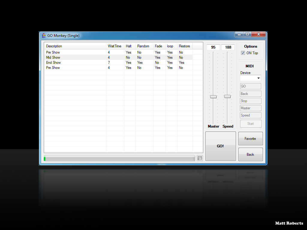

Features:
No Hard limit to the amount of cues you add to the stack
Halt and wait time: Automatically advance onto next cue after the wait time has elapsed or halt on the cue until the go button is pressed.
Set cue properties such as Random, Loop, Restore Previous Values etc.
Master Intensity and Cue Speed fades.
Midi Commands
Large GO and Back Buttons.
Easy XML. Setup your entire show in an easy to read XML format.
XML Description

This is a quick build, started this morning. As i have a small project coming up and need this so the features are currently just what i needed.
The Fiancees school children are running a small talent show, and to get every one involved the children want to do their own lights., so here it is.
Yes the sequences loop, but there can be an option to disable this.
Restore values i can add too.
Its quick and dirty but works if you use it how its intended. After the show il try and improve it.
the XML is case sensitive so Yes and No have capital letters.

I have added the restore and loop options.
Oh And BTW space bar triggers GO

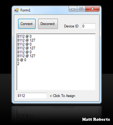

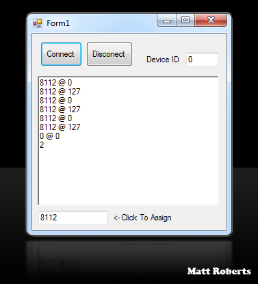

Right iv had a go.
Finding any examples or documentation seems to be very hard. There just isnt a great wealth to go through.
But here it is. I haven't put it into the cue stack just yet as i didn't want to over complicate things whilst testing.
But if every one can test it, then we can add it to the app.
Instructions:
Device ID, For PC that only have one midi device plugged in this would be 0 im hoping to replace this with devices names.
connect, disconnect. Self explanatory really.
When you press connect the number displayed is the number of devices found. The maximum number you should put into device id is this number -1. As the ID's start at 0
If you click in the text box at the bottom and then press a midi key, its Key (Channel number and Parameter combined) will be shown.
When you click out of the text box and press the same midi key again if its value is above 10 it will glow green. This is to test assignment.
Any midi key pressed will show in the large text area. it will contain its Key (Channel number and Parameter combined) and then its value

I have added midi to the program, the only problem is. It seems you can't run two midi software at the same time.

Post by Mattotone »
<cue>
<Cue1>white</Cue1>
<Cue2>running Loop</Cue2>
</cue>
<cue>
<Cue1>blue</Cue1>
</cue>
If you look at the example above. When you go from the first cue to the second cue. only cue 1 is changing cue 2 will remain the same, it will not reset the sequence but continue on.
It works quite well with four cues so far, but updating to ten is easily done, the only real problem is now displaying all the data on the screen.
I may have to cut it down so it only shows Description Halt and wait time.
