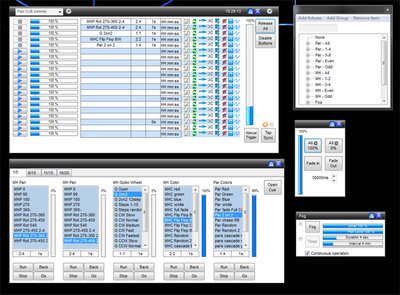

I first have to explain that i use submasters to control my fixtures. Secondly, i use fixture groups. So i can access fixtures how i want by jumping next and previous group on my BCF.
Here a a screenshot of the submasters and group settings so you can see how i use it. (a bigger version is also in the zip file).
Groups and submaster Example

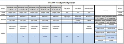

The excel file it self, is a representation of the BCF2000.
- Blue is shift mode. (Push shift, and the blue option is available)
- gray are encoder button assigned rotors (to have the capability to control all the 20 sequence speeds at the same time as using the submaster pages)
Excel screenshot
Excel screenshot
