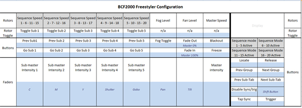

Hi all,
As there are no complete configured layouts available with the functions that i need, so I have made one my self.
But i think that for more people this is handy, so i would like to present my BCF-2000 settings.
I have made an excel sheet with all the button's functions.
Also i made a new.syx template that you need to upload to your bcf, and i created an FMS file with freestyler ver 3.3.1 for easy midi settings import.
All those files are available in the zip file below.

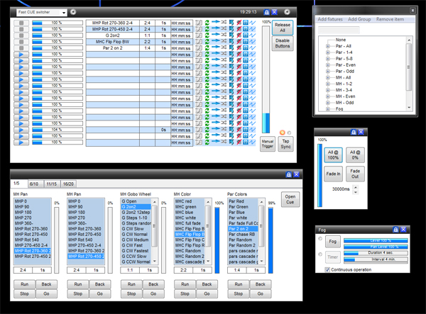

I first have to explain that i use submasters to control my fixtures. Secondly, i use fixture groups. So i can access fixtures how i want by jumping next and previous group on my BCF.
Here a a screenshot of the submasters and group settings so you can see how i use it. (a bigger version is also in the zip file).
The excel file it self, is a representation of the BCF2000.
- Blue is shift mode. (Push shift, and the blue option is available)
- gray are encoder button assigned rotors (to have the capability to control all the 20 sequence speeds at the same time as using the submaster pages)
It took me a long time to build a good working controller config so i hope someone else can benefit of this also.
PS , i am always open for questions, suggestions for improvements and so on.
Best regards,
Bob

This is almost exactly what i was looking for http://www.freestylersupport.com/fsforu ... =16&t=3061

hi Spirit,
I'm setting up all lights accrodingly your set up.
but I have some questions :
how do you manage the focus ? do you disable channel after you fixed the right value ?
and how the manage the pan tilt from MH accrodingly the place you are I mean :
sometimes one of the MV is in the corner of the bar, or along the wall etc... ? do you create some special sequences for that ?
many thx for your help in advance
fred
fred
- fred
- Posts: 28
- Joined: 21 Apr 2011, 20:39
- FreeStyler Version: 3.9
Re: This is how i configured my BCF-2000
oups I think that I found out how you do. you play with the limits "lower and higher"
Freestyler is really fantastic
just let me know if it is the best way
to do it
hi i allways start over and over each time..
also if i allready did a Show 10 times before..
by the 11st time i will save my show
But i put the Focus on the GOBO sequences.. or/and Iris sequences..
and i dont look if the GOBO is sharp but i look if the BEAM look Nice and sharp..
for the pan/tilt i just make i Perfect with the Shapes or FX
i dont use the Correction Feature (can be found on the FS setup) and i also dont use the MIN/MAX limits but if it works ok for you i dont mind it..
/spirit
/spirit

This FX tool is really fantastic for color chaze
but I have no idea which effect could the better one for movments, if you have an idea, feel free
for the "sequence speed" how to say to Freestyler that according to the "SM page" you are (page 1, 2, 3 or 4), for example the rotor #1 will manage the sequence speed of the page 3.
have look the picture below I tried to set up values into Freestyler's midi parameter but I'm wrong.
http://imageshack.us/photo/my-images/37 ... onfig.png/
And I have no idea how to use HTP effects for sunstrip, I haven't found out any button
thx for your help
thx for your help
