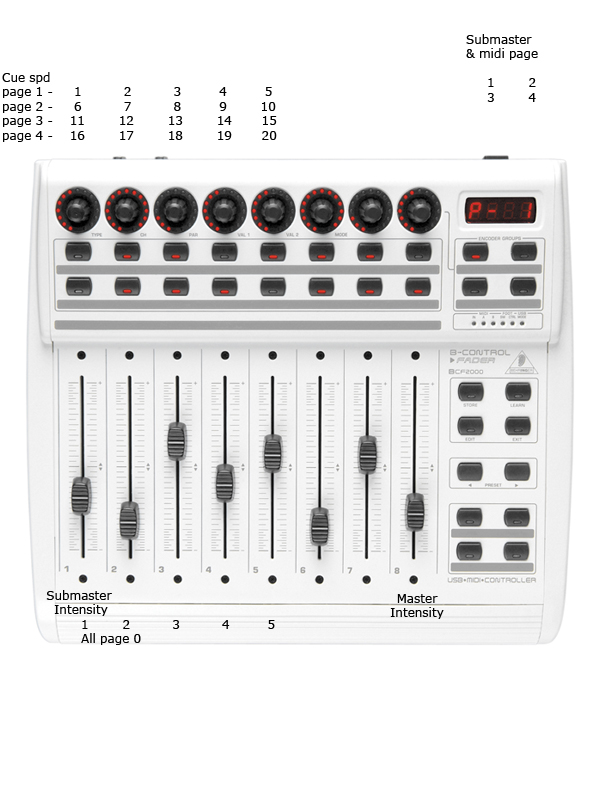

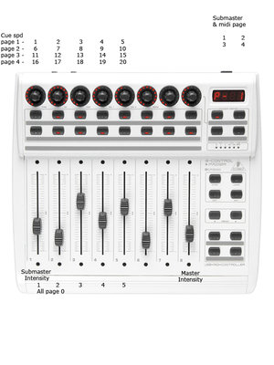

Is it possible to assign 1 button on my bcf that changes the "Midi page" and the "submaster page" at the same time?
So you would get:
Midi page 1 and submaster page 1
Midi page 2 and submaster page 2
Midi page 3 and submaster page 3
Midi page 4 and submaster page 4
To get the 20 sequence speed faders @ the same line as my submasters.
Midi page 1 and submaster page 1 - controlling submaster 1 til 5 with cue speed 1 til 5
Midi page 2 and submaster page 2 - controlling submaster 1 til 5 with cue speed 6 til 10
Midi page 3 and submaster page 3 - controlling submaster 1 til 5 with cue speed 11 til 15
Midi page 4 and submaster page 4 - controlling submaster 1 til 5 with cue speed 16 til 20
this is what i like to create:
I already tried to edit the .fms file. But that doesn't work.
Toggle midi page and submaster page @ the same time?

It is possible, however it required you opening up your BCF and modifying some wiring inside to have it accomplished electronically. There is no way that i am aware of that allows you to program this as the MIDI page is a freestyler function, where the Rotary Encoder Group selection buttons are an internal function on the BCF and have no control over MIDI. If you would like to know how to do this electronically I can explain it to you, however it will void your warranty.

you can do this by using the MIDIOX program on your computer. make mapping so when you send a CC note from the BCF to MIDIOX, MIDIOX send out two CC notes to freestyler; one for midi page X and one for submaster page Xcyberb0b wrote:Is it possible to assign 1 button on my bcf that changes the "Midi page" and the "submaster page" at the same time?

I want the exact same thing but haven't find a way to figure this out. I have looked in to the BCF edit program and MIDIOX without any success. Maby the best way is to ask Raph if he could implement thiscyberb0b wrote: To get the 20 sequence speed faders @ the same line as my submasters.

Thnx for all the info.
I have emailed Raph with the question if he is prepaired to implement this feature.
I don't know if he is willing and has the time.
So we have to wait.
