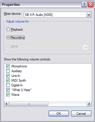

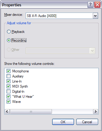

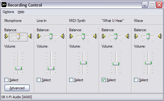

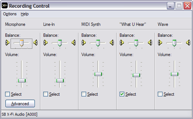

Are we talking about the Chauvet Colorstrip here ? If so there is a fixture already included for it ( I am using version 3.2.9).
Use the Macro screen to access most of the functions, not sure if all the functions are there.
I would say that some of the macros use the fixture own built in "MUSIC" mode, so have music playing that the fixtures can "hear".
If you are trying to use the S2L module and have set the fixture "Let fixture react to sound when enabled" within FreeStyler>Setup>Add/remove fixtures, then if you are playing music from the same PC/Laptop then if you sound card allows it you need to configure the "mixer" record properties of you sound card to listen to "What U Hear".
I access this via the "Speaker" in the taksbar and select properties.
If that is not available then you either need to use the line in to get the music or use a microphone to pick up the music.
I am sure there are people on this forum who can give you a much better answer.
