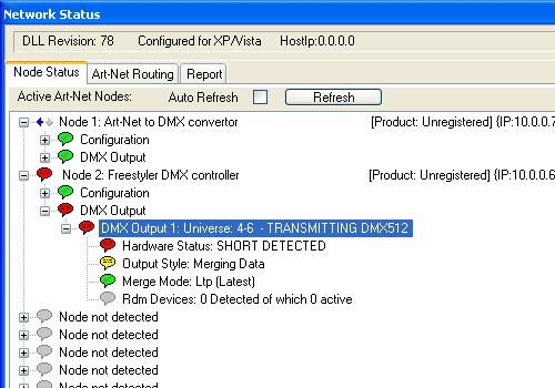

My configuration is Freestyler 3.2.8 using artnet as the interface and running Artnet to DMX on a remote PC, everything is working fine, but......
When viewing the DMX-Workshop to view the network I get the error showing in the freestyler node, there is no DMX interface connected to freestyler just the artnet interface. The error is listed as a hardware short. I have had a couple of email with ArtisticLicence (Artnet owners and distributors of DMX Workstation) and they have suggested that the status returned from freestyler artnet interface is incorrect. I have posted as a bug via the form and hope this is seen by the appropriate folks.
In the picture node 1 is the remote pc with artnet to DMX running and node 2 is the PC running freestyler. I am not sure about the universe indication as it was set to universe 0 in the interface config.
DMX-Workstation network view
