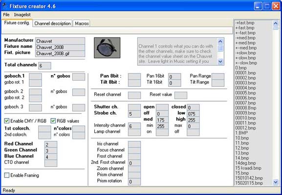

the fixtures are definitely chauvet LEDsplash 200B, or that's what the stickers say on them at least. i bought them ages ago and it's only now i'm getting familiar with freestyler so i will be unable to take them back
i've changed the strobe channel to 5 and intensity to 6 so at least i can control the lights to a degree
remaining problems...
when you click open it makes the strobe 100%
closed does nothing
the intensity; 100% = off and 0% = full.
i changed the 'min' to 255 and 'max' to 0 but then i cannot control the light at all
and the blackout works on all lights except these LED's
surely all 8 lights can't be faulty? anybody got any suggestions?
thanks
m

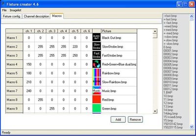

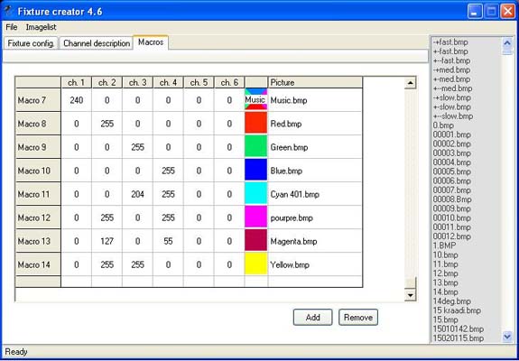

Shannon D
Re: Fixture Help - (Chauvet) LEDsplash/LED-PAR200B
Post by Shannon D »

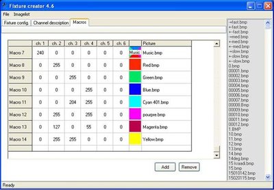

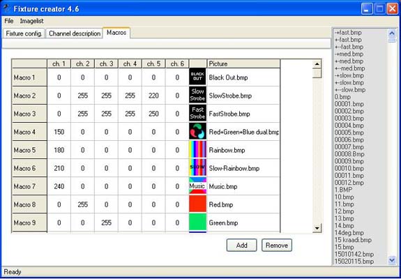

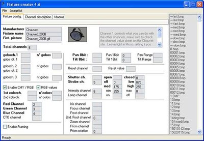

Here are print screens of my 200B set up.
LJ_krede.dk

Shannon D
Post by Shannon D »

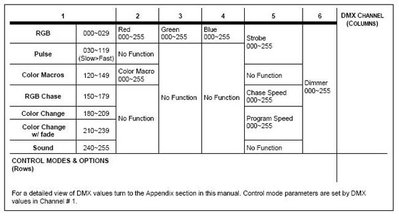

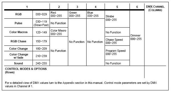

I notice you have intensity set at 255 min an 0 for max ? Is that how it works as it is not clear in the manual just gives a range of 0-255.
When I pulled up the file, I questioned that myself. But yes, that's correct. It just looks odd. Channel 6 is a dimmer channel for that light. So at 0, it is full intensity. The more you increase channel 6, the light dims. 255 turns the light off.
