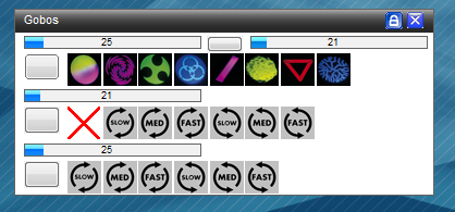

Here is my ficture for my HQ-Power Nexus 250 Scanner. As there is no Category for HQ-Power, I put it here. Perhaps someone can made a category and move the thread to it.
The fixture can also be used for the Futurelight DJ-Scan 260.
I added three additional 2-color values, seperat gobo rotation and rotating gobowheel in three different speeds (slow, med, fast).
Have fun with it ...

Re: HQ-Power - Nexus250
Post by dustin »
Onge wrote:Hmm, a bit strange that config.
Pan/Tilt defined coorect just the text in "Channel description" is wrong. That can easily be changed.
Description is changed.
Onge wrote: You have two definitions for channel 4 (on gobo wheel 1 and gobo wheel 3) with differing number of gobos.
That's correct. I want to have seperate entry at the gobo control panel for the static gobos and the gobo-wheel.
So I have seperated them and now have two lines for this at the gobo control panel.
Onge wrote: You have gobo wheel 1 defined with a rotation on channel 5 and then gobo wheel 2 is defined with same channel number.
These might cause clashes, I am not sure what the priority is on the fields.
Same as above. Seperate control for gobo-rotation and one buttum for stop gobo-rotation.
Onge wrote: Without a manual for this fixture it is hard to make suggestions.
The manual con be found here
Screenshot of the gobo window
