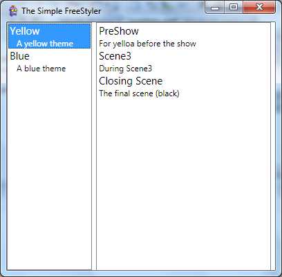

reg
Re: Controlling Freestyler using the Windows API (sendmessage)
Here is the first screenshot (see attachment)
The code is run by an XML template shown here:
Comments please...
Reg
Code: Select all
<?xml version="1.0" encoding="utf-8" ?>
<themes>
<Config>
<FreestylerPath>FS.exe</FreestylerPath>
</Config>
<theme name="Yellow" description="A yellow theme" order="1">
<scene name="PreShow" order ="1">
<description>For yelloa before the show</description>
<FreeStyleCue>12</FreeStyleCue>
</scene>
<scene name="Scene3" order ="2">
<description>During Scene3</description>
<FreeStyleCue>122</FreeStyleCue>
</scene>
<scene name="Closing Scene" order ="3">
<description>The final scene (black)</description>
<FreeStyleCue>0</FreeStyleCue>
</scene>
</theme>
<theme name="Blue" description="A blue theme" order="1">
<description>For before the show</description>
<FreeStyleCue>23</FreeStyleCue>
</scene>
<scene name="Intro" order ="1">
<description>During Intro</description>
</scene>
</theme>
</themes>
Reg

exactly whats needed for retards out there! and XML thats good! damn when your finished PM me and I'll create a download link for it on the forum...

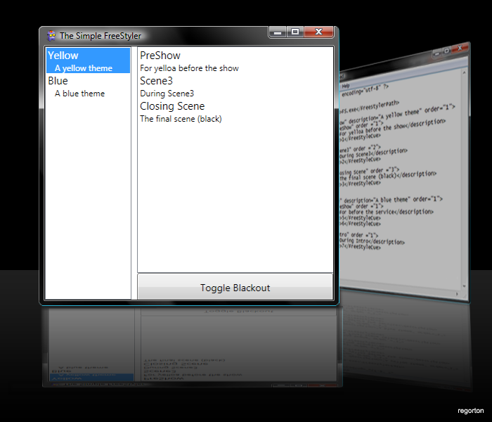

The simple freestyler
Hi Guys,
Attached is 2 zip files. One with the published installer and another with the source. It was written using C#.net Visual Studio Express Edition.
I really would appreciate all comments and advice.
First one: You cant change the xml file unless you recompile the code. Im working on that. But the blackout button should work. Can you please test this.
This is an pre-alpha release. Dont use it for anything.
Reg.
Reg.

Ok,
Update: I have tweaked the code that starts FS. Its still not pretty, but now somewhat robust. This will sure up in the future, but for now, if this loads FS for you, great, if not, tough.
I have also make the XML file an external file. If you search for a file called SceneConfig.xml. This is the XML file that controls the UI setup and which sequences it triggers.
Please give me any and all feedback. Seriously it helps. Comments and suggestions are more than welcome.
Gary, yes this is exactly what I am doing. Someone suggested today that a colour wheel would be a good alternative. Say 7 master scenes and a colour wheel to edit the RGB values over DMX. I might have a look at that next, it shouldn't be too hard. Thoughts??
Reg
Reg

GaryBonaducci
Hi Reg, I got this program to install.
This version still did not start FreeStyler automatically for me. I am running the newest FreeStyler 3.2 on a 64-bit Vista system. For my OS, the FreeStyler program file is located in "C:\Program Files (x86)\FreeStyler" folder (rather than "C:\Program Files\FreeStyler"), so this may be a cause to the problem. With FreeStyler already running, this version did work.
The installer failed to put the XML file in the program folder, so the interface was blank when I first started it up. When I placed the XML file into the program folder, I was able to get the menus to appear. The program appears to work correctly, and I was able to switch between the five sample sequences.
I find your button labels and descriptions better than what's currently available on FreeStyler, but I still don't see you going in a direction that I would find useful or efficient. For example, to switch from the Yellow Preshow sequence to the Blue Preshow sequence requires two clicks: First on the "Blue" in the left column, and second on "Preshow" on the right. This doesn't make things more efficient, one might as well go back to FreeStyler's Cue palette where in one single click you can switch from sequence 1 to sequence 4. Also, until you add controls to switch cues, this approach is limited to twenty sequences total.
On Friday, I began experimenting with FreeStyler's built-in touchscreen mode, and I have to agree with Remko_K that it could be sufficient for your application. For example, based upon your XML file and UI setup, in FreeStyler's "Touchscreen Userinterface 2" mode you can replicate your current XML controls with six touchscreen buttons: Your five example buttons and a Blackout button--all accessible with a single click, rather than navigating through panels. You can even color code your buttons for Yellow, Blue, and any other themes.
As far as the touchscreen is concerned, it's 99% there for me and only missing a few features that would get me to use it. To give you an idea of my requirements, I already have about 12 Cues that hold about 205 Sequences, and an additional 60 color Overrides programmed on my console. (Many sequences are duplicated across the 12 cues because I need certain scenes always accessible, so there's actually only about 75 unique sequences on my system.) So as it stands, unless if you intend to expand your UI to allow accessing Cues and Overrides, I have to honestly say I don't see it turning into something I could use.
Hey,
I have finally got around to having another play with this.
Changes:
You will also need .Net 3.5 SP1 runtimes.
Let me know what you think.
I have added the new version to the first post as requested.
I would really appreciate comments now. I feel it is working perfectly for my needs (it is going into a live installation tonight)
And a big thanks to Raph for 3.2.1!!!! Its awesome! Cheers!!!
Changes:
- Changed the layout of the window, such that it resizes correctly and looks better (in my opinion)
- The software now continuously checks if FS is running and blocks the screen if it is not.
- A menu bar has been added. It allows editing of the XML file with notepad.
- A few other code clean-up things.
- Removed the installer as it was rubbish.
TheSimpleFreeStyler0.0.0.5.zip- (157.27 KiB) Downloaded 645 times
