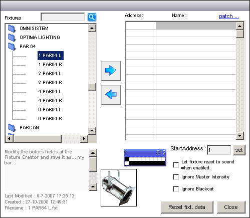

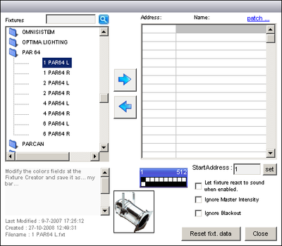

A single spot light attached to a dimmer pack (or build in dimmerpack), are the easiest things. They use 1 DMX channel.aemzxd wrote:I am trying to find a fixture that is a spot light. It is a single 750 hologen light . not sure on the brand but it is running on a dimmer rack . that is hook -up through a dmx control. I had it running with this softwere and the hard drive died . i am also having a problem creating a fixture for the can light's . I all am useing this to control the can lights in the ceiling too. Need help please ! Like I said it was running and the computer died. The friend I had help me set it up is in the amy. he is now over seas so go to go to plan B
Just select in the fixtures list the PAR64 category and insert the 1 PAR64 L (or R, does not matter), make sure you assign the right DMX address and it will work, even when your fixture is not a PAR 64 fixture. DMX dimmers all work the same: 1 DMX channel. (0=off....255=full)
The same goes for the can lights. Say you have 4, you can add 4 of the 1 PAR64 fixtures, or just 1 of the 4 PAR64 fixture.
Ofcourse, when you want, you can also select the PARCAN category and locate PAR_BLUE for you blue lights, and PAR_RED for you red lights... And so on.
And when you have it all up and running, make a backup.

I'm amazed; There is no PAR 64 category in the fixtures list?aemzxd wrote:I was also looking in the fixture set up were it says add and remove fixtures under the set up tab and I did not see any par lights.
Like you see here: Something must be wrong with the FreeStyler installation. Please remove and reinstall.

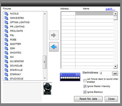

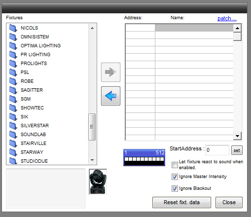

The install must have went wrong. I took a screen shot of what I have. I am reading up in the hole dmx stuff now . Is there any other web sites that have more info. Thank you for all your help guys

I tryed reloading it and got the same thing . There is no par light's in add fixtures. I might have see it when I was creating a fixture. I went to save it and I saw what you are saying but it is not there when I try to pull it up under add and remove fixtures. I think you are running a different version. will keep hunting are around to see if I can find it.
