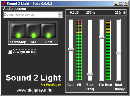

And here comes the good news:
Raph and I contacted eachother after a public call for help to all beta testers :mrgreen:, he wants to release a new version of FreeStyler soon, but the old SL.exe is indeed somewhat heavy on certain machines and unstable. He can't find the time nor technology to create a good working version of Sl.exe.
So I started writing a complete new Sound 2 Light application. It is in internal beta test now, it will be beta released soon. And if it all works out in time, it will be released the same time a new release of FreeStyler comes out.
So, in a few weeks, all of our problems are solved. (But new may arise :mrgreen: )

At the moment it seems I have exceeded myself and wrote the S2L app using about 0% CPU on an 1,5 GHz P4. :mrgreen: And yes, it worked.
Now we need to beta release the app and make it fool proof. Then it will be ready for the world.
I just asked Raph do to that so I guess that beta e-mail of him wil come soon.

iv just had a play with the new s2l, it is a massive improvement on the old, the detection rate is alot more acurate and CPU ussage is way lower.
if your looking for suggestions, being able to select the frequency range the beat detection works with would be good for differnt genres of music.

Yes, in one of the next upcoming versions I'll implement multiband analysis of the audio, users then will be able to select the frequency (or band, or both) where the beat trigger works on. Maybe I will implement a simpler version so that you can select the frequency with 2 + and - buttons, like the old SL.exe app.
Anyway, for a very first beta release it seems to be working very good! :mrgreen:

The first beta release turned out really well, so there is a new beta out now.
Raph is going to mail it to the beta testers, and I figured to post the url of my website here, so more people can test the new sound 2 light app:
http://www.digiplay.nl/fs/
For all you nerds a nice screenshot: :mrgreen:
You might want to backup the old SL.exe app, as the setup of my SL.exe overwrites the old one.
I added few new features and functionality, see my website for details. I'm not planning to implement more functionality for the time being. Unless it proves global major improvement somehow and if I can find the time to do that.
What this version (0.0.0.2) of SL.exe can do, is what I had in mind to have pretty good sound to light functionality.
Please all test this beta, as this beta should become the first official release soon. For bug reports and other stuff you can contact me via e-mail, found at the bottom of my website.
And if the number of downloads is one when you enter the site, then you are the first to download! (besides me...).
