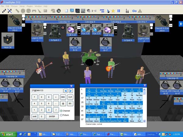

I think he means setting values in the sliders of the fixture channels and in the set chaser speed of the cue window. I thought this would be handy a while back, as sometimes its difficult using the mouse to get to an exact value. Sometimes it takes a few trys and other times you just have to settle for a number close to what you want. Not sure how to implement it.

That's exactly what I mean.Shannon D wrote:I think he means setting values in the sliders of the fixture channels and in the set chaser speed of the cue window. I thought this would be handy a while back, as sometimes its difficult using the mouse to get to an exact value. Sometimes it takes a few trys and other times you just have to settle for a number close to what you want. Not sure how to implement it.
Sometimes it is very difficult to set the exact value via the sliders. If you want "50" as value you get "49" or "50".
I don't know how to realize this, but for me it would be great feature. Particularly I don't have an external midi controller.
Shannon D
Re: Keyboard to set values
you can use the command line to set exact values
Thanks LJ,
I know the command line use to be on the tool bar in older versions, but can't seem to find it in 3.2. Not sure how to access it in 3.2.
EDIT: Hit the "GO" button,, duhh!
OK, so can someone explain the how to use the new command window? I never used command for anything, so not sure all what it can do. Maybe this should be in another thread. But maybe answer how to use it for the original question of this thread.
Thanks LJ,
Got it
I did have to fumble with it for a lil bit. I was selecting a fixture, selecting channel in the command box and typing the codes. I didn't see anything happening in slider window of the selected fixture. Channel means the channel in the 512 universe, NOT the channel of the selected fixture. It's easier to see if you open the "show output" window.
So to get the pan on fixture #3 to output 133, you type 27@DMX133
Got it
LJ_krede.dk
I'm sorry, I left that part outShannon D wrote:I did have to fumble with it for a lil bit. I was selecting a fixture, selecting channel in the command box and typing the codes. I didn't see anything happening in slider window of the selected fixture. Channel means the channel in the 512 universe, NOT the channel of the selected fixture. It's easier to see if you open the "show output" window.
