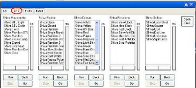

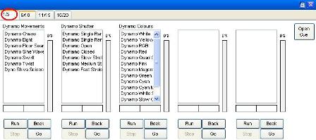

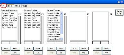

I currently have all the attributes (eg shutter, movement, colour, gobo etc) for each fixture programmed into the sub fader display screen. My two fixtures are Geni Shivas and the much simpler Acme Dynamo:

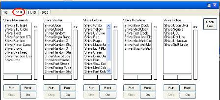

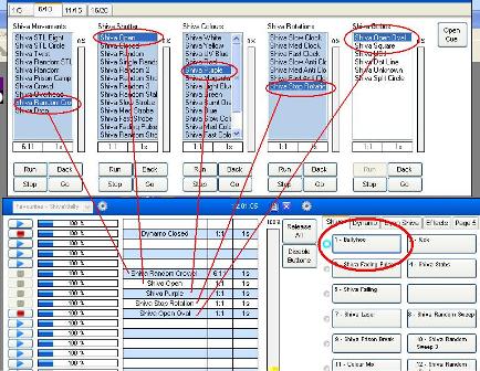

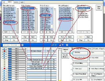

If I want to create a chase for the Shiva’s, I select one or more attributes and then save them as a cue. The saved cue is then added to a cuelist button. The following is an example of a ‘Ballyhoo’ chase:
Notice that:
• Each attribute occupies a specific line of the fast cue selctor list depending on which submaster has been chosen
• I‘ve had to program a ‘closed shutter’ sequence for the Dynamos to stop them from stayimg lit during the chase.

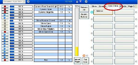

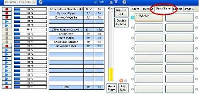

• I have different pages of cuelist buttons for each fixture type and one extra page for cues that involve the Dynamos and Shiva’s. The image below is a Ballyhoo using both fixture types
Now what I would like to do is eliminate these ‘shared’ cuelist buttons and be able to have a more than one cuelist button active at one time. Perhaps restrict it to only one cue active per cuelist button page?
