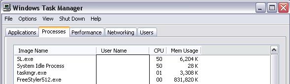

#2, Then I use freestyler, is used 800 mb ram? is this normal, and if I used sound to light function is uses 100% of one if my CPU cores, hectic??

I guess you are not using the newest FreeStyler as with that setup came a totally new Sound 2 Light application which uses much less CPU than the previous S2L did. Your profile confirms that so: upgrade your FreeStyler.yofo wrote: #2, Then I use freestyler, is used 800 mb ram? is this normal, and if I used sound to light function is uses 100% of one if my CPU cores, hectic??
If having the same RAM problems with the newest FreeStyler:
Where do you get the info from FreeStyler is using 800 MB of Ram?
Can you make a screenshot of the windows task manager tab "processes" then?

yea, 100% CPU usage on a 3.2Ghz core is insane
I have a core2due "two 3.2Ghz cores"
here is the screenshot

Freestyler uses 41 MB ram on a 15 step max "[NumberOfScenes]"
I have edited my freestyler.ini file so that I have a max of 999 steps, this is probably why it uses 800mb of ram

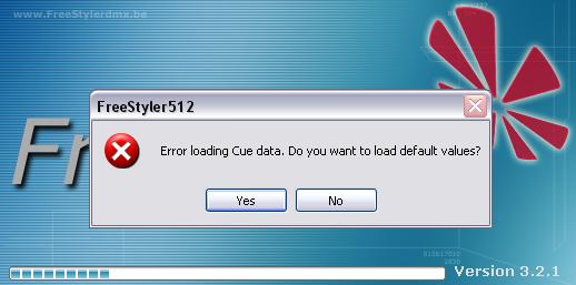

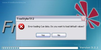

What does this error means? If I start up the program it tells me this

Oops, sorry my bad, can you maybe tell me that is that error message, and how can I fix it?

I have not seen this error before but it looks like FS is looking for some cues to load and they are not there anymore, maybe you have deleted them?
I guess fs still runs ok if you click yes ?
