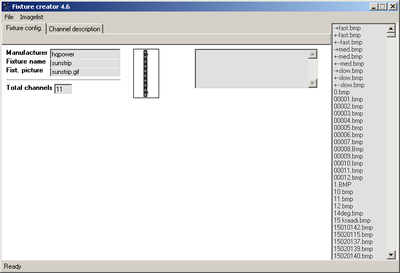

the file seems damaged?? The fixturecreator window is just blank when i opening the file.
Is it me (my system) or does anyone else have problems?

i only see an empty file with 11 dmx channels (where the sunstrips only have 10).

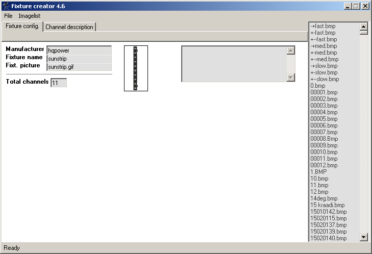

Define blank?LJ_krede.dk wrote:the file seems damaged?? The fixturecreator window is just blank when i opening the file.
Like this?: Guys! I thought you all know better!
A sunstrip is nothing more (and less) than a 10 channel DMX dimmer, and so is it created in the fixture creator. Thats how it looks...
Just 1 parameter: number of channels.
And just 1 tab: description of channels.
Also there are sunstrips that have 1 control channel (to start build in chases) and 10 dimmer channels.
So a DMX channel description could look like this;
1. Control
2. Dimmer 1
3. Dimmer 2
4. Dimmer 3
11. Dimmer 10
Exactly the way the .pff is configured. It only seems that the showtec sunstrip is a 10 channel device, with just 10 dimmer channels and no control channel.
I thought I read that somewhere, but I guess I'm confused with some other brand or model.
