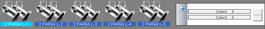

For example, when you use 10 PAR's that are mounted by 2 next to eachother. (and so 5 of these sets) you can add:
5x 2 PAR64 L
In FreeStyler this should look like this:
When selected 1 set of 2, you can control both dimmer channels manual indepentently at the right side of your screen - ofcourse more advanced sequences are possible.
The text "Color1 and Color2" is somewhat strangely choosen by the author of these fixture files, but you can read them as "Dimmer1 and Dimmer2".
And since you have 5 of these 2 dimmer channel fixtures, you have 10 independent dimmer channels to control.
It does'nt matter if its called PAR64, its just an image in this case. The internal DMX controlling of the dimmerpack is the same: a dimmer channel (0...255) per PAR64 spot.
