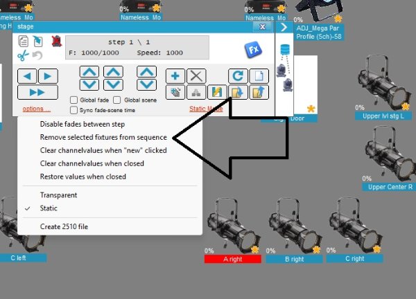

There is an option (see the attached JPEG) to remove selected fixtures from the Sequence. Click on options.

Re: remove fixture from sequence can no longer edit it
Oh nice, thanks so much. I will try that for sure. I very much appreciate your help!
