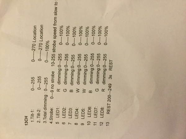

Post by sfina »
Hello I have same lights but with 13 channel any help
Attached is the 13 ch description
