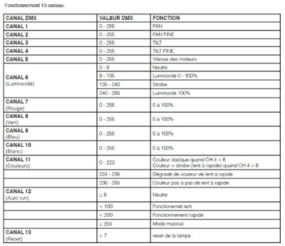

I have 2 Mini Moving heads and configured it for freestyler. Everything is working fine, except when i use the master dimmer, my light starts to strobe for a little moment.

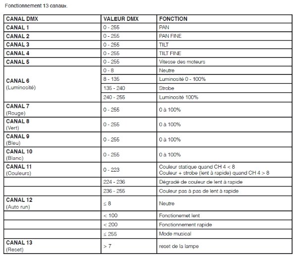

I found that in the dimmer channel also the strobe channel is foreseen ... You can see it in the attached dmx table.
Afther i found this, i changed my dimming value from 0-255 tot 0-134. But in real time, the fixture then gives me white light output that i can dim. So i can not change the red, green, blue, ... values ...
Is ther a solution where you can dim the RGB channels with the masterdimmer ?
Or how can i fix this please ?
Anybody that can help me please for this ?
Kind regards !

Just a few comments
- The 13 channel chart has an error. The channel 11 function references channel 4 - the correct channel is 6 based on the rest of the chart.
- Your macro 1 (RESET) sets channel 6 to 255. According to the Chart this should be channel 13 (which you correctly coded in the Fixture Config tab - you probably do not need this Macro)
- While it is certainly okay the macros that set colors are just duplicating your color wheel (if I read everything correctly).
- In the Channel Description tab you set the default for Channel 6 to 255. This may cause you problems the first time you reduce intensity using the Master Dimmer. Consider changing the default to 0.
-In the Fixture Config tab consider either removing the Shutter Channel entries or else setting the OPEN value to 134 and the CLOSED value to 8
- In the Fixture Config tab I think you should change the Intensity Channel minimum to 8.
If you decide to make these changes please test and let us know the results.
Good luck!

Hello,
Thanks for the reply !
Some remarks and tests:
1) Your first point with channel 4 must be 6 is correct.
2) The reset is not for resetting the fixture, but to set the programm channel in zero.
3) I know that the macro is used double(instead of the colourchannel). But all my RGB fixtures have the same macro's
. Marco 0 is reset colour, macro 1 is red, macro 2 is orange, ... So every fixture has the same precolours programmed
4) I changed the shutter values (255-134), the dimming values (0-8) but the dimming, master dimming is not correct.
!!! The weird thing is that when i set dimmer in 8, no light, seems correct, and then i can use red, green, ... channels. Red and green only dimmable with their channel.
When i open more the dimmer, to for example 30, the light is starting to give a white light (RGB mix), and is starting to overrule the red, green, colours (not the channels.
When i open the dimmer to maximum (134) than it is full white (RGB) and everything i setted up is overulled.
When i close the dimmer again. Then the red, green, come back ...
Strange but maybe this is the fixture ???
