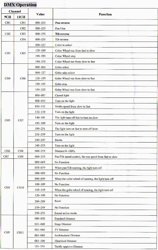

Hello Community,
here is my Fixture for the mini moving head "LIXADA Mini Gobo LED Spot 25W" for 11 channel mode, which I've bought from Amazon (https://www.amazon.com/Lixada-DMX-512-A ... B0168LVUSK). I've added the gobo pctures in the fixture as well.
For reference I've added the scanned manual as well.
Lixada Mini Gobo LED Spot 25W.pff- Freestyler fixture
- (57.13 KiB) Downloaded 1056 times

Make sure channel 7 is set to a value the will turn on the light
Make sure channel 8 is set to a value that is high enough to see the light.

According to the information in the chart in the first post of this conversation, when the instrument is configured in 11 channel mode then channel 9 controls the pan/tilt physical movement speed. A value of 0 sets the speed to its maximum speed and a value of 255 sets it to its slowest speed.
