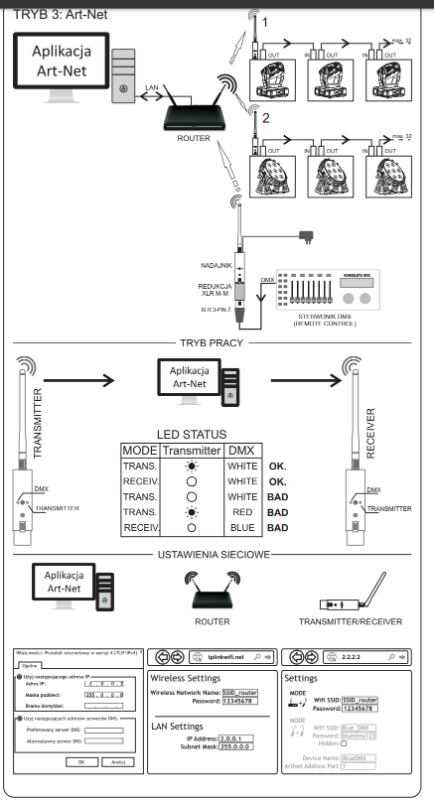

Now I've got the following interface: SigmaNET BlueDMX wireless ArtNet and DMX WIFI transceiver (Manual: http://www.sigma.net.pl/down/BlueDMX_In ... a_v1.0.pdf)

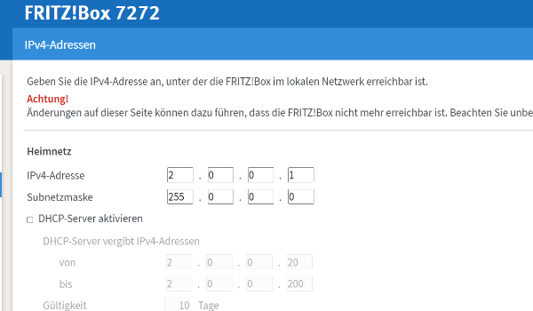

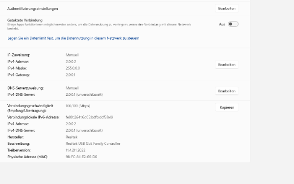

I installed variant 3: Windos11 via Lan to Fritzbox 7272 and BlueDmx as receiver via WiFi from the router.

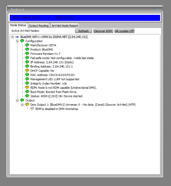

The configuration seems to be correct because the interface can be seen in the DMX workshop. But it doesn't receive any data.

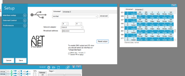

Artnet over wifi is really difficult to set up and is not a supported method of Artnet.
The most common issue is that your Wireless router does not support the broadcasting of packets.`
Try using unicast by typing the ipaddress of the Artnet receiver into the broadcast address box
