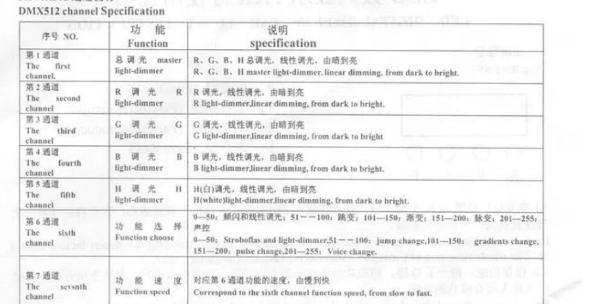

Hello all. I have a couple of Chinese par led fixtures that have 8 channels described this way:
CH 1 - Dimmer
CH 2 - Red
CH 3 - Green
CH 4 - Blue
CH 5 - White
CH 6 - Has the following programs:
0-50: Strobeflash and Light Dimmer.
51-100: Jump Change.
101-150: Gradients Change.
151-200: Pulse Change.
201-255: Voice Change.
CH 7 - Corresponds to the 6th channel function speed, from slow to fast.
CH 8 - Not specified.
The question is how to configure this fixture in FIXTURE CREATOR for a propper functioning of the unit. From channels 1 to 5 I'm fine, it is self explanatory. Setting channel 6 to strobe works OK but acting this same channel as the strobe speed and not engaging the other programs contained in this channel.
Channel 7 is the one in charge of controlling SPEED of the 5 programs contained in channel 6ab I have not foun a way to configure this. Any idea on how to do this in FC?
Thanks. Any help on this wil be gratly appreciated.

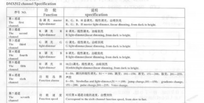

Hi Partyman, thanks for replying. Find attached exported fixture and a copy of the fixture channel configuration
