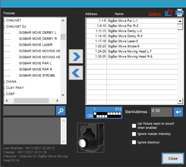

DMX Fixture
01 Par 1 (Start DMX Channel)
06 Par 2 (Start CH + 5)
11 Derby 1 (Start CH + 10)
14 Derby 2 (Start CH + 13)
17 Laser (Start CH + 16)
20 Strobe (Start CH + 19)
24 Moving Head 1 (Start CH + 23)
30 Moving Head 2 (Start CH + 29)

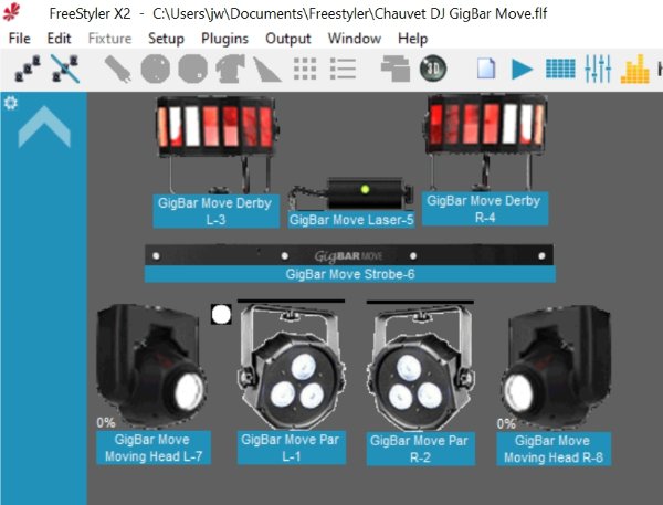

The below image shows how it should look in 'Add Fixture' and the location file in freestyler. Both images are inside the zip and are not needed by freestyler.
