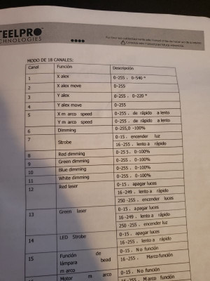

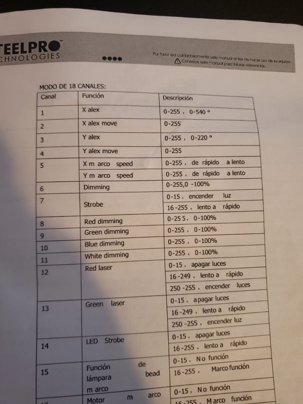

On channel 5 i got 2 values from 0-255 how do i set those values on my custom fixture?

I'm not sure why it says that but it's the speed control for both X and Y i.e. pan and tilt,
However if you did want to separate you put the pan and tilt speed on a custom slider on fixture creator, if you have two functions on the same slider either use the label to mention that or simply have 2 sliders with the same channel but with different labels. They'll do the same thing but you'll know what they are for...
