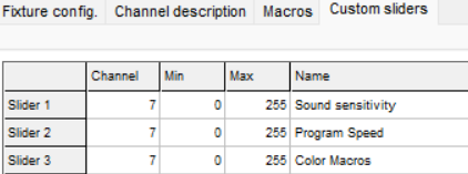

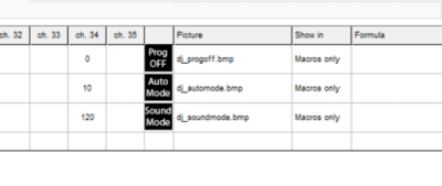

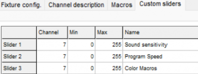

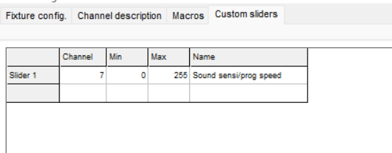

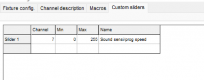

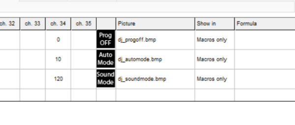

In this context I create buttons to operate the settings on channel 6 in the macros buttons then use the custom sliders to map the channel 7.
Every option I click on the macros then just needs the channel 7 adjusting on the custom sliders, I could make just one custom slider labelled with all it's functions or say 4 custom sliders that only operate channel 7 labeled with the what it does i.e. a slider that says 'sound sensitivity' then a slider that says 'program speed' etc. they will all operate the same but to the user it makes it easier to understand...
