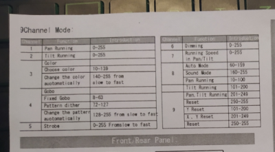

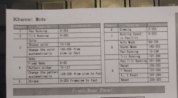

Hello Dear Ladies and Gentlemen of Freestyler.
I have recently purchased this moving head and am now looking for the right fixture for it.
https://www.amazon.de/UKing-Fernbedienu ... 7W5S9?th=1
I have seen that they already have a fixture, however mine is not compatible with theirs because I only have 9 channels in DMX and their version is made for 21.
I ask either for a creation which I will of course gladly pay or somewhere a hint where I can get the right fixture.
Thanks

Hello,
Does your instrument also support 11 channel mode? If so are the 2 additional channels PAN FINE and TILT FINE. If they are you should consider operating in 11 channel mode as this will provide finer Pan and Tilt control.
