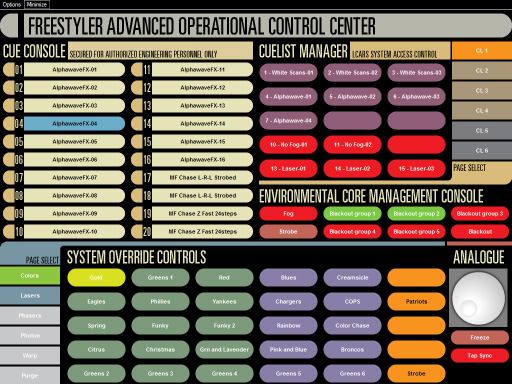

Attached below is a ZIPped file that contains the bitmaps needed to create the Star Trek "LCARS" interface I have shown above. This mod only works with the current release, version 3.2! This interface also is intended to work best as a playback setup where Cues and Overrides are primarily used to create lighting effects. It is formatted for a 1028 x 768 display.
IMPORTANT! Before trying this out, create TWO backups:
1) Use FreeStyler's "File > Backup/Restore" function to create a backup, and
2) Duplicate the entire "\FreeStyler\Images\Touch" folder, and rename it "Touch - Original".
Without making these two backups, you will not be able to undo any of the changes below and revert to your current touchscreen setup!!
Follow these steps to install and setup the LCARS interface:
1) Create your two backups! Use FreeStyler's Backup function to create a regular backup. Then, navigate to the "\FreeStyler\Images" folder, and duplicate the "Touch" folder. Rename the duplicate folder to "Touch - Original".
2) Exit FreeStyler.
3) Download and unzip the attached file. It contains a folder called "Touch - LCARS" that contains 33 bitmap images.
4) Place the unzipped "Touch - LCARS" folder into the "\FreeStyler\Images" folder.
5) Delete the bitmaps in the "\FreeStyler\Images\Touch" folder. (You backed up the contents earlier, didn't you?)
6) Copy the thirty-three (33) bitmap files from the "Touch - LCARS" folder into the "Touch" folder.
7) Start FreeStyler.
8) On the touchscreen interface, you should see a new background image plus any previously placed buttons. It is easiest to layout the LCARS interface from scratch, so use the "Remove All Buttons" command to clear the screen.
9) When the screen is cleared of all buttons, you will see a layout pattern plus instructions in yellow "Post-It" notes. These instructions will tell you which buttons should be place in each area. Additionally, the appropriate "colors" for the buttons in each area is listed.
FYI, here's a breakdown of the new buttons used in this layout:
Gray, White, and Black buttons = 202 x 36 pixel buttons
Red, Yellow, Orange, Green, Blue, and Darkblue buttons = 128 x 48 pixel buttons
Pink and Purple buttons = 128 x 36 pixel buttons
Custom buttons = 120 x 40 pixel buttons
10) When all the buttons have been laid out, exit FreeStyler. Navigate to the "\FreeStyler\Images\Touch" folder. Delete the file "background.bmp". Duplicate the file "background - full.bmp", and rename it to "background.bmp".
11) Start FreeStyler, and the finished touchscreen background should appear. You may need to shift around a few of the buttons a pixel or two to get it aligned perfectly.
