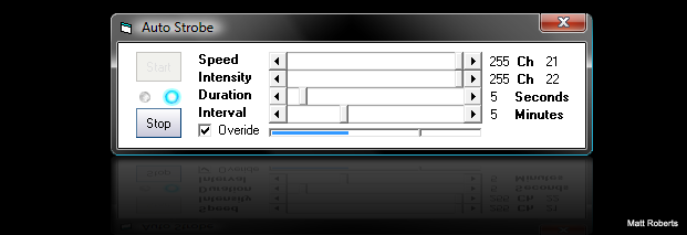

Auto Strobe Timer
Interval insteps of 30seconds from 0 - 15minutes.
duration insteps of 1 second from 0 - 60 seconds.
chanels can be set by selecting the channel number and entering the new value.
V1.2
Channel names can be set be selecting and entering new value.
I.e Fog, Fan, speed, Intesity etc
v1.3
No transparent text boxes in hope to eliminate fm20.dll error, removed traces of Microsoft Forms 2.0
can be used on any two channels so not limited to just strobes, 2nd fogger etc.
if you require longer intervals, durations or channels just pm me and il send you an update.

Re: Auto Strobe Timer
start FS -> start the timer app.
then in the timmer app set the channels to the channel you want to control i.e the channel with the fogger or strobe.
set the interval/wait time and then set the duration/on time.
press start and away you go, it is set as an overide so if you have a sequence that controles the channels the app will overide them.
in vista you need to run as administrator so that windows will alow the send message commands.

user requested version with a 5minute duration (300 seconds). built from version 1.3

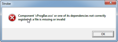

Hey when i try and run this it comes up with this error
cProgbar.ocx is missing or invalid?
sounds like your missing the vb runtimes.

Getting cProgBar.ocx errror on my windows 10 system... works great on my win 7, tried to run as administrator , set to compatibility mode win 7... upgraded Freestyler to 3.6.43...
thanks
Spent couple hours on this today and same result reloaded PC and tried second PC. Anyone able to load this strobe Timer on Windows 10 64bit?
Thanks
thanks
Thanks
- Posts: 3
- Joined: 01 Nov 2017, 23:02
- FreeStyler Version: 3.6.4
- I Use FreeStyler for: Band
Aargh, Figured it out does not work with msvbvm60.dll had to download msvbvm50.exe from MS run exe then reboot it works. Yay!

Hello, It doesn't start for me.
cProgBar.ocx problem. See the attachment image, screenshot.
Edit: Sorry, already have an answer here.
msvbvm50.exe downloaded, run as administrator (from c:/Freestyler folder)

cProgBar.ocx??
W10
Its now a very old application written in VB, no longer supported.
