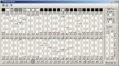

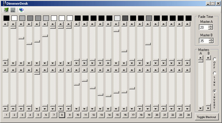

Telnet Fader Interface
Features
TCP fader interface for Freestyler, allows control of fixtures over a network at a secondary location.
2 Channel Banks for setting presets during show.
Master Fader for each preset, with independent adjustable fade times.
Cross Fade, linked fade and individual master fader control modes.
Global Blackout
channel intensity indicator shows current intensity of the channels output
flash buttons to flash channel to full intensity
hotswap connection allows you to connect to any address or port without having to restart the program.
changeable start address sets the faders to start at any channel
Built in telnet client to send commands directly to freestyler.
address, port and start channel remembered so no need to configure when re open, and all saved within the software no external ini files needed making this ultra portable.

sorry guys had to take it down, was crashing the telnet server when doing large channel fades.
Trying to work on a solution the easyiest would be going direct without the telnet.
Would this still be usefull to some?? any other suggestions?
iv started on adding a cue list with Go and Back buttons, fade times, and Auto Durration which continues to next cue after durration with the ability to add "stop and wait for manual", Loop back for set num of times.

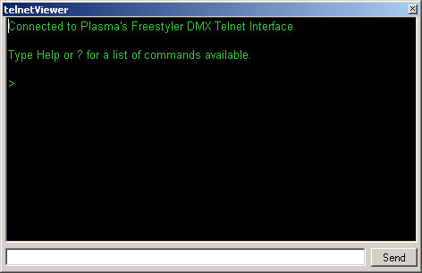

Anything I can help with? If you tell me how to replicate the problem I'll have a look see if I can fix it in the Telnet Server. A little busy with work at the moment, not getting much play time with FreeStyler. I'm away on business as of tomorrow till Friday so won't be able to do much till I get back.Mattotone wrote: was crashing the telnet server when doing large channel fades.

its when using the | command. I.e channel 0 @ 255 | channel 3 @ 255.
it works for two commands after that it seems to crash.
Plasma
Re: Telnet Fader Interface
I tried sending a few comands ..Mattotone wrote:its when using the | command. I.e channel 0 @ 255 | channel 3 @ 255.
Code: Select all
>red 100|blue 150|green 50|inten 20|shutter 255|masterspeed 10|focus 100|gobo1 200|gobo2 50
Cyan / Red Channel Command Ok!
Yellow / Blue Channel Command Ok!
Magenta / Green Channel Command Ok!
Intensity Channel Command Ok!
Shutter Channel Command Ok!
MasterSpeed Command Ok!
Focus Channel Command Ok!
Gobo 1 Channel Command Ok!
Gobo 2 Channel Command Ok!
>Code: Select all
>channel 1 @ 255|channel 3 @ 255|channel 20 @ 100|channel 200 @ 30
Channel Command Ok!
Channel Command Ok!
Channel Command Ok!
Channel Command Ok!
