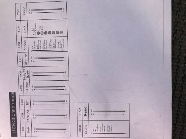

I need help with a profile for my new lights. There is very little information in the manual. I am attaching a photo of what info is available. They have 8 colors and 8 gobos that's about all of the info that I can find. I cant seem to locate a list of the gobos and colors. Thank you for any help you can give me as I am new!

I took a chance and developed a fixture.
The color wheel is there just to give you an idea. If you can supply the colors and DMX values I will update the fixture to correct the color wheel.
The gobo wheel may have the correct images but the DMX values are not correct. Please supply corrections so that I can update the fixture.
Also, if you can post a clearer picture I can create custom sliders for the sound and strobe functions.

[Yes that is my light. The images on the site are not in correct order. I will do my best to explain. Colors are as follows, 1-white, 2-red, 3-green, 4-blue, 5-yellow, 6-orange, 7-cyan, 8-magenta. Then it goes to split colors. 9red-white, 10red-green etc thru the colors at 127 colors begin to rotate counter clockwise and at 192 they begin to rotate clockwise. Gobos are as follows 1-circle, 2hashed star, 3 triangles, 4-swirl, 5 star, 6spots or dots, 7 locked circles, 8 segmented star then they repeat with shake. at 127 they begin to rotate ccw and at 192 they go clockwise. As I stated I am very new to freestyler was using an elation board before this. I will attach a higher res image of the manual Information. Also I wanted to thank you VERY much for your help. Very Kind of you!

Thank you for the info. That will help. With your information I can place the colors on the color selection window in the correct order and provide custom sliders for the rotation. With the Elation board can you see the DMX values? Without the correct values the color selection window will still not provide the desired results. If the DMX value is not available from the Elation board then you can use Freestyler to find them. To accomplish this you would use the standard slider for channel 8 in the upper right corner, moving it and making a note of the value in the Show Output window that selects the color.
The same comment applies to go the gobo. I can order them correctly now but will need the DMX values for the gobo selection window to work as desired.

Sorry for the delay.. That took a minute. White=0-6 no7.ed 8-15 no 16, Green 17-23 no 24, Blue 25-31, Yellow 32-38 no 39, orange 40-46 no 47, cyan 48-55 no 56, Magenta 57-63 no 64, Split red/white 65-72 etc. Colors rotate ccw 128-191, Colors rotate cw 191-255. Gobos-Circle 0-6 no 7, hashed star, 8-15 no 16, Triangles 17-23 no 24, Swirl 25-31, Star 32-38 no 39, Spots 40-46 no 47, locked circles 48-55 no 56, Segmented star 57-63 no 64, 128-191 ccw rotate, 192-255 cw rotate. I hop this helps. Again THANK YOU so much!
