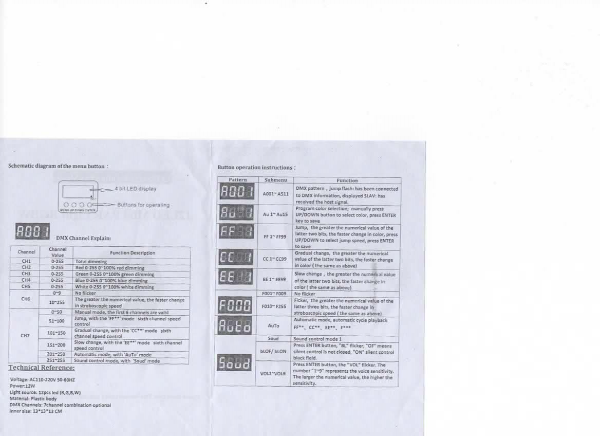

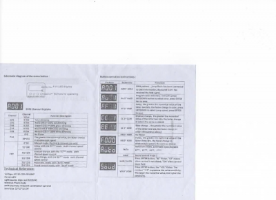

Per the topic, I'm a total newbie with both Freestlyer (using it in conjunction with a Lixada uDMX Dongle & VirtualDJ 2018) but have just about got to grips with the whole DMX concept and am now dabbling with the Fixture Editor.
Problem I have is that when using one of the Generic 7CH RGBW fixture profiles, all the scenes I CAN make seem to be overtaken by the subject unit's Auto sequences. In addition, changing the generic ones Channel 6 to strobe just makes the White either constantly on or part of the original scene I make.
I've tried searching the web for a suitable fixture file etc, but cannot seem to find one and editing the Generic one has me fixing one issue and breaking another. I guess I must be missing something and would really appreciate a few pointers in how to create the correct fixture file in order to control 2 of these DL-6's either simultaneously or as a group - with the correct results i.e. either by DMX scenes/controls/sliders or by Sound to Light.
