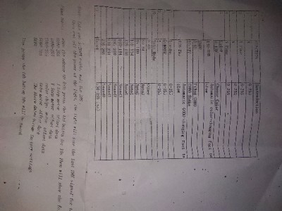

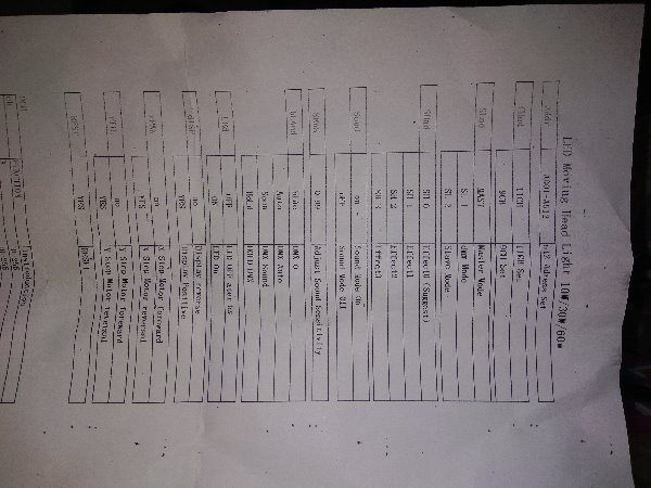

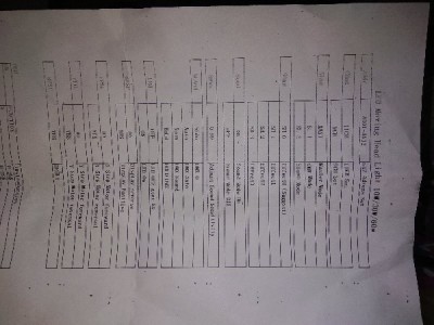

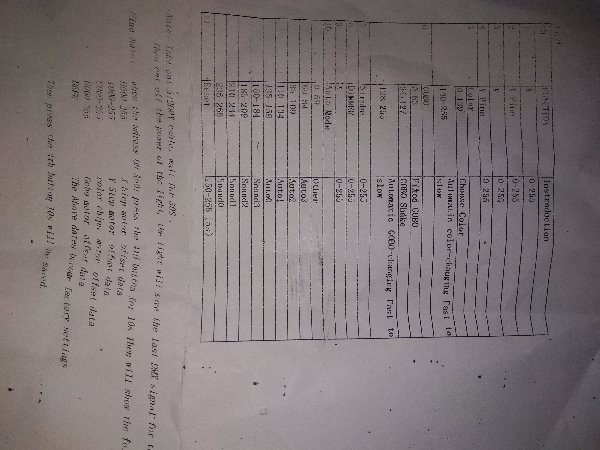

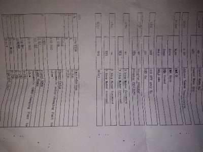

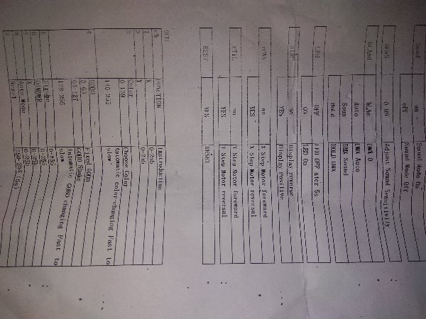

I am attaching the scanned images of the paper sheet I got with that light.

A fixture definition must be created in Freestyler and then loaded onto the Freestyler workspace. The lights must have an address. They can both have the same or they can be different. If different then 2 fixtures must be loaded into the Freestyler workspace (and the correct addresses specified!).
