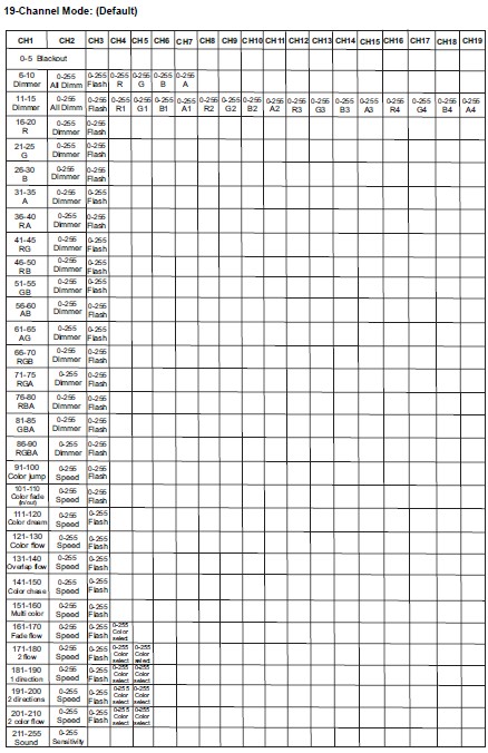

I tryed to make a fixture profile for 19 channel mode but it isnt very good.
Can any one Help ?
It's mainly the Amber channel how messes things up ...
Dmx-chart under :
http://images.prolighting.de/manuals/00053149.pdf
And I would like 19 channel mode, I know that 6 channel mode is easier and I've done it and it works fine.

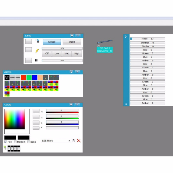

How to create this fixture with 19-ch?

I tried to create a fixture with 19CH but I have a problem with RGB Segments. I set the parameters: 1 row with RGB Segment per row: 4 + Amber. FC created this segments, but I don't know how to assigned to Channels 4-19 of RGB segments.
Also I have a problem with Macros - according to user's manual in CH1 I set Mode channel. I don't know what's next.
I'm beginner user of Freestyler and Fixture Creator.

Sorry for the late answer.
You just enter the channel no in the colored field as in this segment tutorial.
http://www.freestylersupport.com/wiki/f ... t_tutorial
Regarding macros on channel one then this fixture is a bit tricky to get a easy usable user interface on.
But for a start I think I would place channel 1 on the shutter channel with "close" = 0 and "open" = 13
Then you have a normal working fixture when you open, close and makes blackout
Then the macro you just add macros and enter the values for channel 1 and in you case only channel.
You need to play with the macros to see what work best for you.
There are also tutorial on macros.
You can eventually export the fixture in pff format an upload it here so we can have a look
