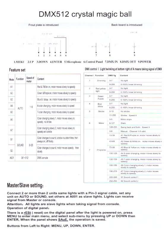

Hello, I need fixture file for my Chinise Magic Crystal Dome.
Can anyone please help me?
Added the DMX table to my post
Need Fixture for Jelly Dome!! Topic is solved

Re: Need Fixture for Jelly Dome!!
That looks pretty straightforward. If you open a similar jelly par fixture in the fixture creator you could probably just swap some channel numbers around and pretty much copy t already exists, and maybe sort a few channel values on macro tab if you want them.
