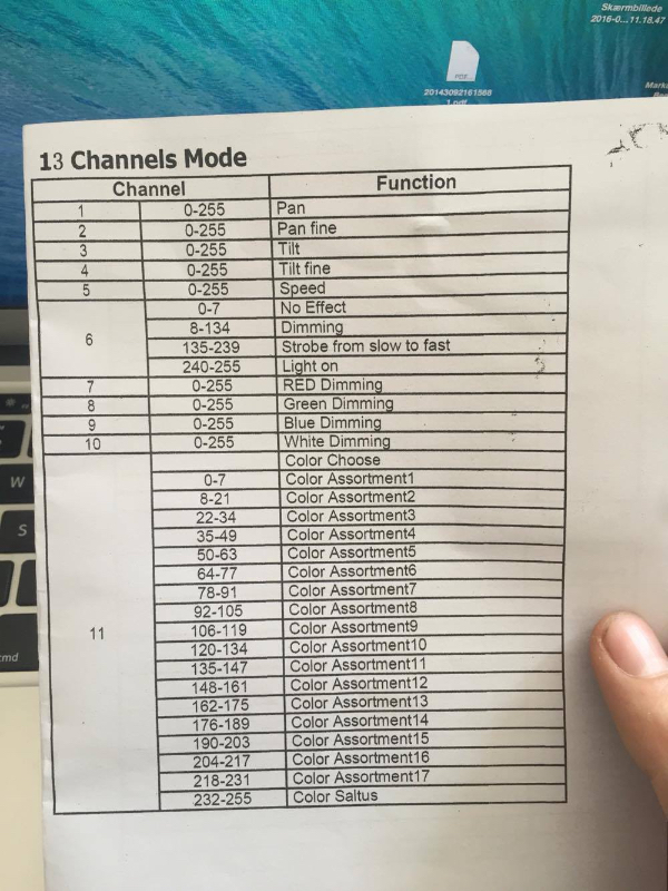

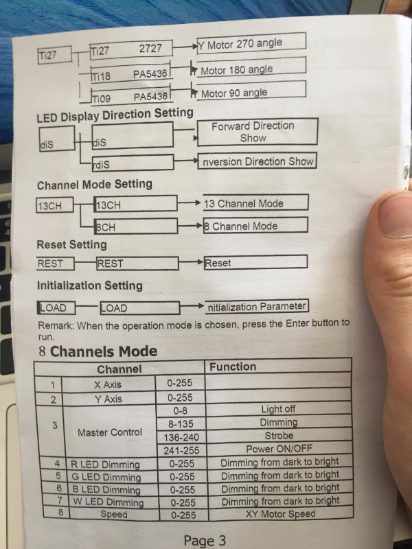

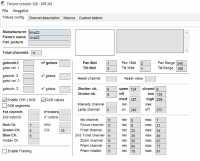

Hi!
We've bought these movingheads: http://www.ebay.com/itm/141953061670?_t ... EBIDX%3AIT
We can't get any signal through and we are not sure if we are "creating" the fixture right in the Fixture Creator.
This is our interface: http://g02.a.alicdn.com/kf/HTB11o74HVXX ... ontrol.jpg
We are not sure if the choose the right type of interface? We chose uDMX. Is that right?
I have attached pictures of the manual for the moving heads and how we tried to create a fixture.
Please help!

I think I have added two pff files...if i have import these to fixture editor and try them.
I have two types of these lights, and neither manual shows the correct channels but these fixture steips work with mine...
MINI WASH 2.pff
(2.34 KiB) Downloaded 19 times
MINI WASH.pff
(2.32 KiB) Downloaded 20 times
