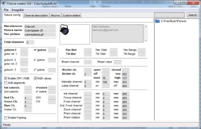

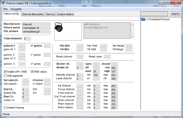

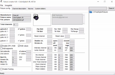

I've got 4 Chauvet Colorsplash JRs. There was a supplied fixture and I modified it and used it.
I'm using DMX400 if that matters.
Only fixture #1 works properly. The others don't 'map' correctly.

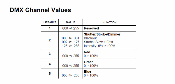

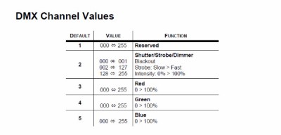

DMX channel 2 is
000-001 Blackout
002-127 strobe slow>fast
128-255 intensity (0-100%)

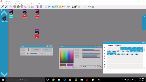

When I select all fixtures, look at the 'show output' window and drag the intensity slider in the lamp window, on fixture 1, I can see the value change from 128 to 255. On the other three, the value changes from 0 to 255
Help!

Re: Fixtures not responding properly

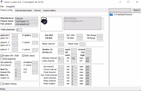

The fixture I have looks a bit different.
I have also noticed that FreeStyler has become a bit sensitive to the char in the "Fixture name" field so mine had movement panel when I tried you issue but when I removed the "." then the movement panel disappeared. (ColorSplash JR. -> ColorSplash JR)
Hej again
I have been playing a bit with this issue and I can replicate it.
It is a bug and I have raised it in the "Bug Tracker"
