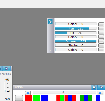

Iv attached a screenshot with what i have so far
color1 at the top doesnt do anything
pan works fine
tilt works fine
color2 doesnt do anything
dimmer works fine
strobe works fine
color1 at the bottom changes the color,
Strange though because the channels do not match those in the manual.
Manaul My Settings
Strobe 5 Strobe 6
Pan 1 Pan 2
Dimmer 4 Dimmer 5
Im still working on the color

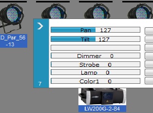

I don't know what fixture you are using but it is not the one from your original post.
It look like this.
(27.17 KiB) Not downloaded yet

It is the fixture file from your original which is not the same as the one on you fader image.
The fader image I posted is how your fixture file from the original post looks when add it to my setup.
Yous should be the same and it is not.
If it is not the same then you are not using the fixture file you think.
Try to give it a fixture name like "Slender Beam Quad 1" or "Test 1" then you are 100% sure that the correct fixture file.
It may be and idea to remove the fixture and then add it again and then be 100% sure that you are using the correct file.
Also open the output monitor panel and see that the faders actually are changes the channels correct.
