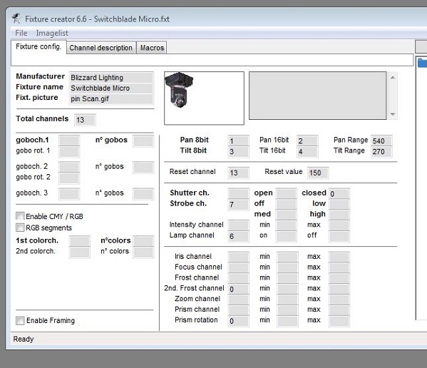

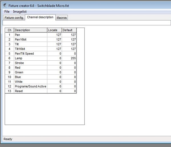

I'm building my first moving head fixture file for the Blizzard Switchblade Micro (similar to the ADJ Inno Pocket Spot) and I need some help.
In sound active mode (Ch12 value 241-255) the colors will change but there isn't any Pan or Tilt action happening.
Do I need to create a macro for channels 1(Pan) and 3(Tilt)? Or am I missing something somewhere else.
Thanks for your help.

Re: Blizzard Switchblade Micro sound active not moving
Hej DJspeckNC
I had a look on you fixture and it looks okay.
There are some values missing for the strobe channel, Ch7, off = 0, low = 1 high= 255
This should however not have any influence on the movement.
The error must be somewhere else.
You can open the output monitor and there you can see what values Freestyler are sending on the movement channals.
