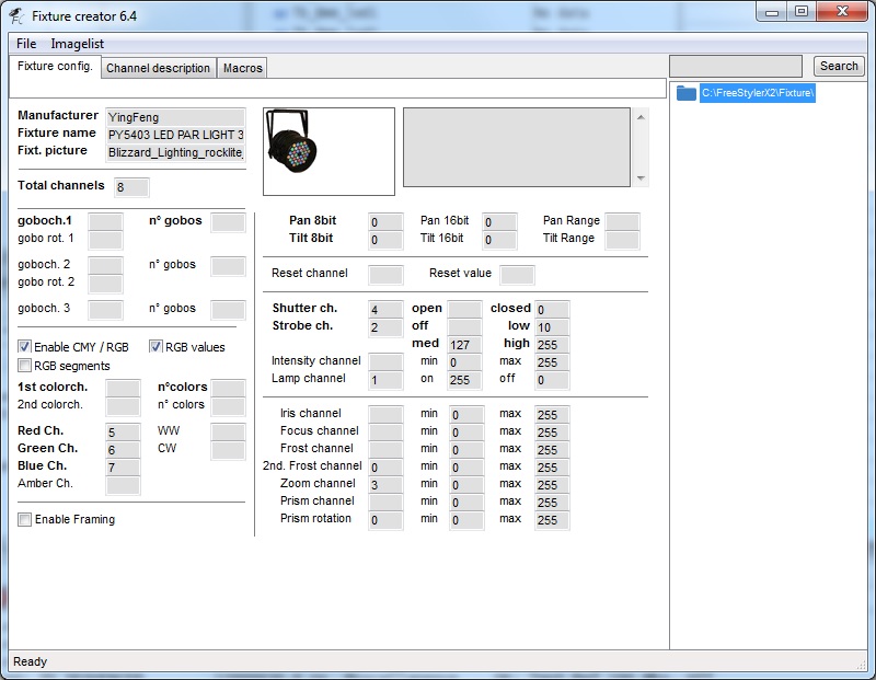

hi,
i'm newbie in lighting :? :?
i need help with simple light PY5403 LED par light, i already try to create the fixture by my self, but seen like it have something wrong. and in this fixture, how can i put mood music? i mean for the light to follow music?
and also with macros, can anyone teach me how to understand about the macros..
i know i'm new here to get help but please i'm begging to get help from your guys :cry: :cry:

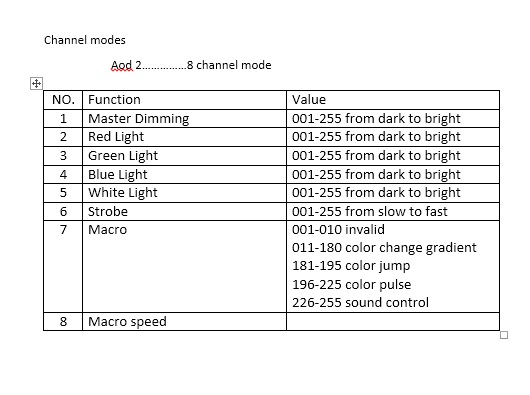

Is there a page in the manual that tells you what the "macro" dmx values actually are?
Usually in the form like 1-50 = blackout, 51-100 = dmx mode, 101-150 = sound reactive, etc, etc.
glaxius
Re: Need a fixture for your light?
Post by glaxius »
none.. in that manual, only what i attach are given..
spud1511 .. is this the information that are needed?

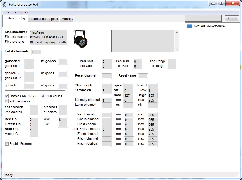

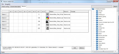

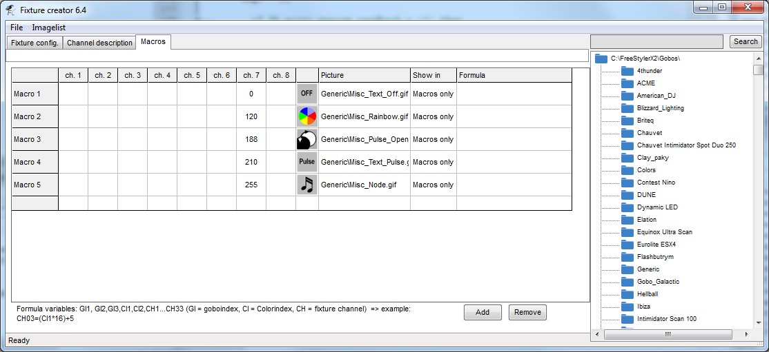

Hej glaxius
You have not placed the channals right.
Red, 2 goes on red ch = 2
Green, 3 goes on Green ch = 3
And so on.
At the end it should look like this.
glaxius
Re: Need help on creating fixture for PY5403 LED Par Light
Post by glaxius »
hai Jan_k
thank you so much, now i know how to put the macro.. and thanks again
my lighting work perfectly..
