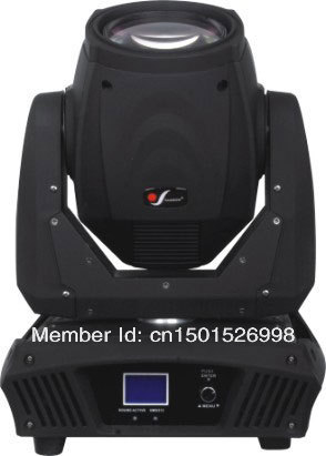

I CAN´T FIND THE FIXTURE FOR THIS LIGTH BEAM 200W MODEL VS 2061 CHINESE LIGTH IT SEEMS TO BE 20 CHANNELS LIGTH IN THE EXTENDED MODE
NO MANUAL OR CODE FOR CONFIGURATION WHAT CAN I DO PLEASE HELP...!!!
I NEED HELP "FIXTURE FOR A BEAM MODEL VS 2061 200W" Topic is solved

If there is really no manual then that's chinese crap for you.
You will need to patch a "generic 20 channel" fixture file to freestyler, connect the light via an interface, then using the right hand sliders find out what each channel does and make a note, then build a fixture file from the notes.
I'm afraid if there's no manual then we can't help as we physically don't have the fixture like you do.
EDIT//
Just to let you know within 5 minutes I've found 4 companies that sale the fixture, so I'm sure if you email one of them you can get a manual for it.
