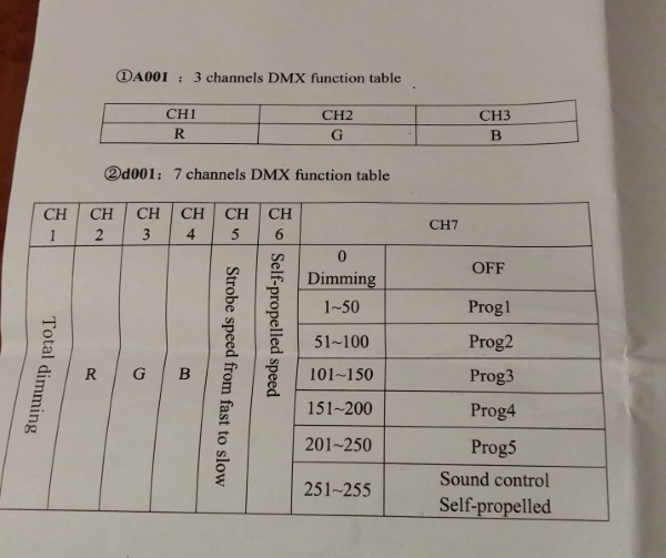

I need a bit of help setting up a Chinese PAR light I got.
I've created a new fixture and got R G B and the Strobe to work, but have no idea on how to program CH 1, 6, or 7 -- if that's even possible. Not exactly sure where to put the values within Fixture Creator.

Re: Help with Chinese Par LED
Hi,
Looks really similar to one I had so I just tweaked couple of values to make it fit.
Main things to remember when testing;
* You will need to set the master intensity / dimmer up to see anything.
* There is no proper program speed option in freestyler so I used the 'zoom' slider to control the speed of the lights built in programs.
The auto programs on the light can be activated by clicking the macro button for whatever program number you want to use, but if you do dont forget you will need to set all your other sequences to SNAP to OFF to turn it back off again.
Obviously I cant test it for you so good luck!
Everything works!!!! Thank you!
