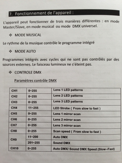

Hello everyone,
I bought several sets of light
I want to use Freestyler, but I have trouble using fixture Creator
Can you help me create the fixture for the excelighting Hydre II
as an attachment you will find the photo of the manual for the DMX configuration
Thank you to you for your valuable help

Once you have created you first fixture then you will see that it is not difficult to understand.
The Hydre 2 is a bit more tricky because this one you need to create as 3 single fixtures.
And you in the table the led patterns are not listed meaning you have to find then yourself.
When you run into problems then ask and I will try to guide you.

yes that's what he seemed to understand.
it is possible to create only the channel 9 and 10 to start using it in auto and music mode ? Without all channels ? this poses no problem to use I think?

Yes you just make a dummy fixture with a total of 10 channals.
When you want to control the fixture then you use the fader in right side of FreeStyler.
