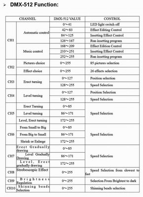

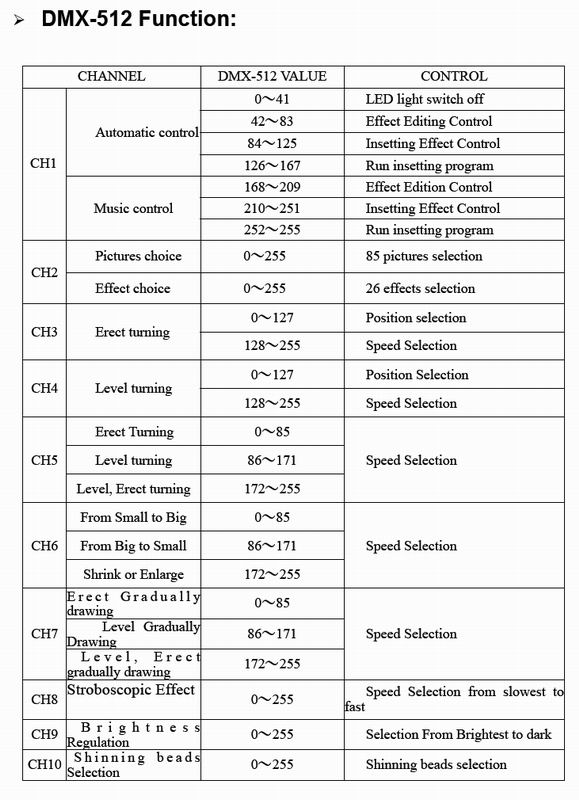

HI, suche für den Stariville Matrixx SLB-15 LEd die Fixture, komme leider in dem fall nicht mit dem Creatore klar, bin nicht in der MAterie drin.
Hat die Fixture wer? Gruß Andreas

Hej Andreas
I have had a look on the DMX table.
It is not an easy one to make. I think it requires that the fixture are available to test the functionality and to find the dmx values for the pictures and effects.
You are probably the one of the few in this forum that have one.
I think you are to make this by your self.
And it is not that difficult. Just start and when you run into problems the place a note here and we will help you.
I will suggest that you make a scanner fixture with 10 channels in fixture creator and then hook-up the HW.
You will then have 10 faders available that you manually can adjust.
Then you are started.
