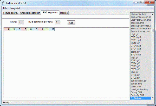

Has anyone used the fixture by pro shop simply called the LED STRIP ? we are having trouble creating the fixture in fixture creator and would really appreciate some much needed help/assistance...
pff and pdf files attached, please check it out and see what you think.

Hej Imagination
There are a difference in the two data sheet you have attached.
You need to figure out which one fits your fixture.
The UM_LEDSTP100 has a dimmer-strobe-macro control on channel 1 and then color control and the LEDStrip has color control and then Macro control on Channel 13.
Looking on the fixture I think if was to do it then I will place some of the color control on segments.
But I don’t how this will work with the whole RGB dimmers on the first channels.

imagination
Re: Pro Shop LED Strip fixture request
I believe the one with Red starting on Channel 2 is the correct one, when we control it via a simple DMX desk red starts on channel 2, green 3 and blue 4. Channel 1 is strobe, fade etc
